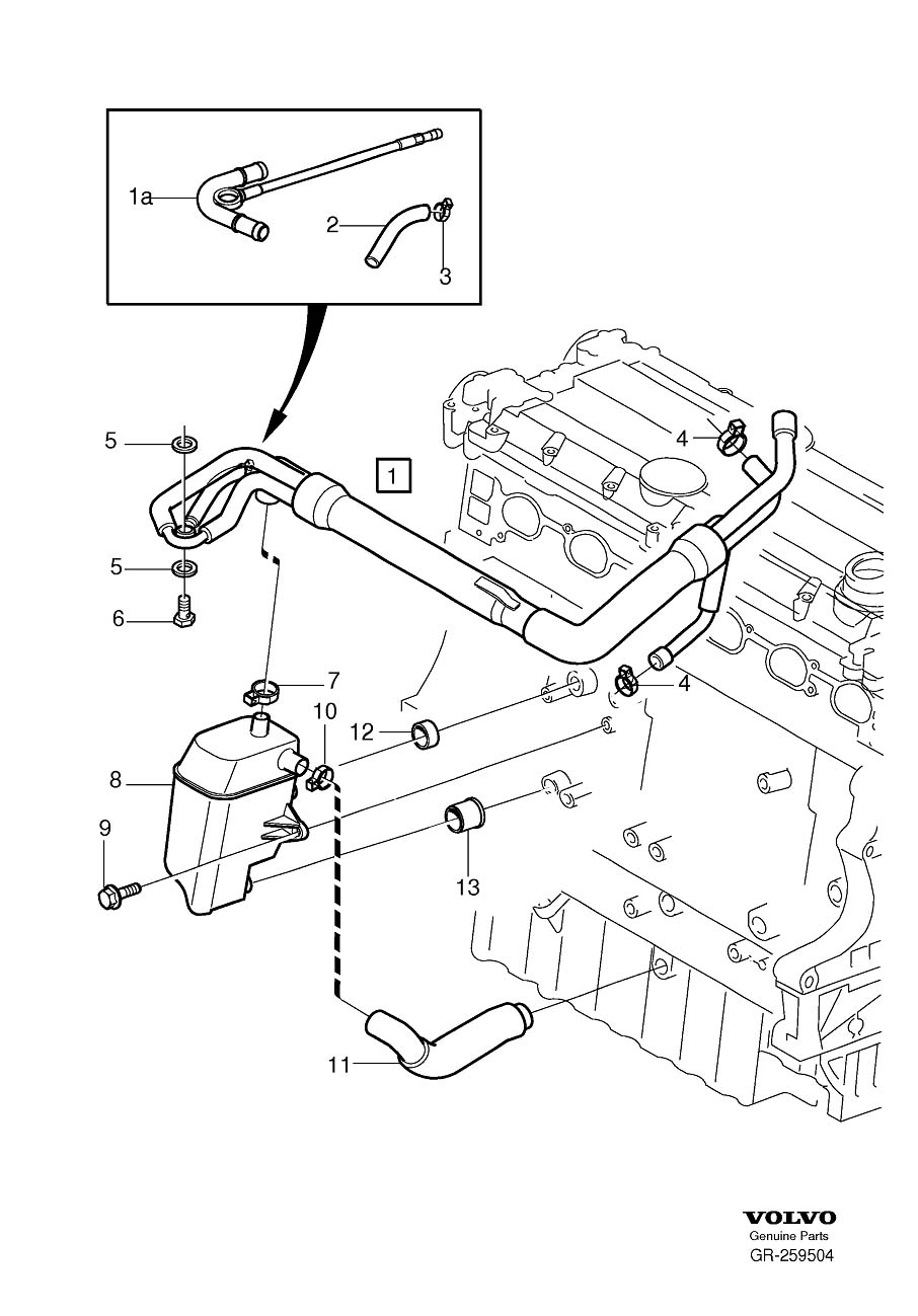

    Its called PTC nipple isn't it?

    Quote Originally Posted by 2002V70XC View Post
    Nope, that's on the other end of the hose.

    Quote Originally Posted by Antherzoll View Post
    is it the "Crankcase Breather Hose Nipple" from this site: http://www.pelicanparts.com/catalog/...FULEMI_pg2.htm ?
    Sorry I couldn't upload the image. The upload control didn't work at all on Chrome!

    Part: 1a

    very nice photo! Thanks Antherzoll!
